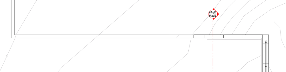

Here is another example that illustrates the problem with not being able to show walls on any or all stories desired.  In the attached images, there are two retaining walls built perpendicular to each other in the screen shots.  Some of the walls are modeled on Story 1 (the taller ones), some on a lower level.  They all have stone coping on them.  The stone coping is modeled with a custom profile and applied to walls.  But as you can see in the plan view image, only the stone coping placed on Story 1 can be seen on story 1.  Stone coping placed on lower levels will not display.  This is so frustrating that GS does not give us the ability to view walls from any story to any story.  BTW, changing the cut plane to below the 1 story changes nothing in plan view to help show the coping below, as suggested by someone else here.

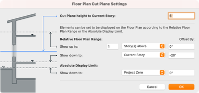

I am not talking about wall settings.
I am talking about viewable stories inside the cut plane settings.
Match that with the correct view settings for the wall and there you go.

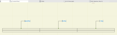

@rm see following screenshots and tell me what I am missing
--Walls in 3D with custom profile and on different stories
--Walls in floor plan-- Label is set to display story name
 -- Cut plane settings
Walls are set to "All relevant stories" but as @Lingwisyer indicated this is a blunt approach and there might be other items affected by the change in cut plane so your wish for more options is not a bad idea.

Thanks for posting screen shots of your settings.  We were doing just as you showed.  Then we were saving the changes to the drawing with the "Redefine with Current Window Settings".  For some reason, the settings were not actually getting saved to the drawing, so every time we went back to the Cut Plan settings, they reverted back to where they would not display the walls a story down.
We deleted the file and went back to an earlier version and applied the same steps.  This time the settings "took" and now we can get the results we were hoping for.  I'm not sure why it was not working on the other file, perhaps it had some level of corruption.
So I stand corrected, what SenecaDesignLLC was describing can work and what you showed in your screen shots can work.

Just to be sure (and for other users), remember that cut plane settings are saved by view so when opening a view with different cut plane settings and then moving to a different story items might look weird.
