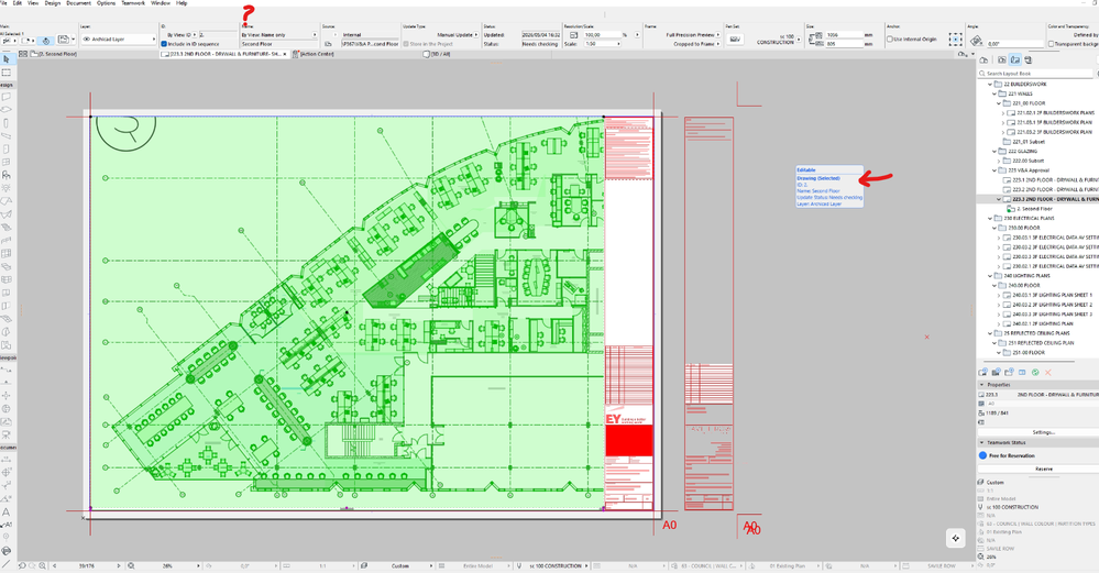

Hi all.
When I select views in a layout, I can't deselect it again.
Archicad is still active, but I can't do anything. When I minimise  and maximise again, the tools dissapear in the top bar, and my ouse recognise that the drawing has been selected when I hover my mouse over the workspace area.
I also can't select anything else in archicad.
Any ideas?
1 Solution
JohandT82
I found the solution...
The notes viewmap in the master sheet was from an external source. I exploded it and now it works...
