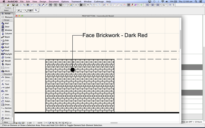

I was wondering if anyone knew where to get or how to customize a Wall Label so that i can have it displaying the Surface of that wall. These would mainly be used in elevation views where i want to document the claddings being used.
Currently i have labels with custom text which i edit and manually input the surface that it is pointing too. I have tried making a few with the some of the preloaded labels but couldn't get the desired outcome.
This image shows my desired label but with manually edited text.

Sorry, heres the image of what i was after.
