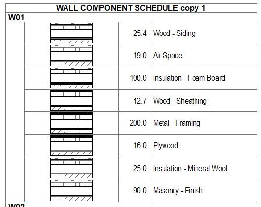

Our office is in the habit of creating a visual wall type schedule.
The 1st drawing is an example.

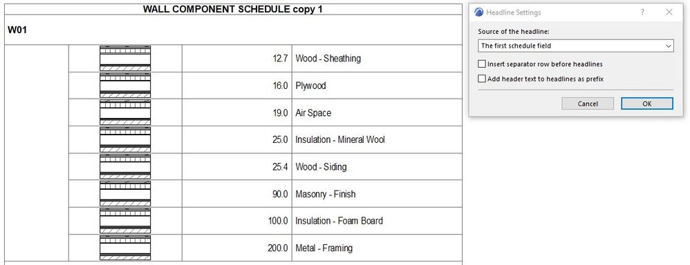

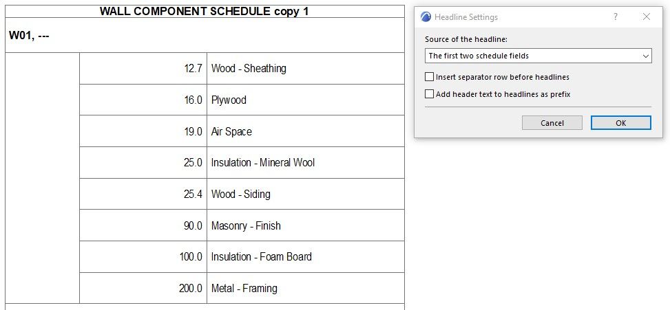

I can create something similar in Archicad, but it seems to show the plan view of the wall multiple times.
The 2nd drawing shows the multiple same wall in the schedule.
I would like to show it only once, but I cant seem to find the setting.

Maybe you can use a 'headline' for the first two fields, so that the preview ends up in the header.

Thanks Erwin,
Unfortunately, the wall plan view disappears completely when I select that option.

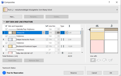

This is how I do it:
This is a small piece of wall with a custom label on it. The label separately:
It lists the layers with a few more info, than the default one. Every physical property is coming from BMat level data:
The thicknesses from composites, the heat transfer coefficients can be entered in the object.
It's pretty much WIP, I don't really have the time to finish it atm...
If you would find it useful, I could try and patch it up a bit to be more useful.
Then I just save a view from that floor plan, and I can arrange it layouts, or discuss the material properties with other consultants, and enter them directly.
