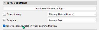

For an enlarged plan, you need to save a new view with an enlarged plan attribute set...
When you work with rotated views, you need to take the mark off the box that says "ignore rotation" at the bottom of your view settings window.
It is a bit counterintuitive, but you will get the hang of it.

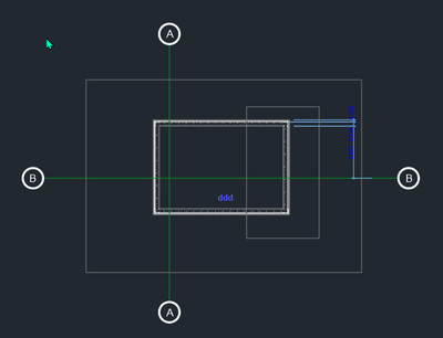

Can't you show it as an image?
I am a newbie and non-English speaking person.
I can't find mask in help.
It seems to be the function you mentioned, but nothing has changed.
What exactly are you talking about turning this feature on for?
AC27 on window 11
A mask is a fill.
workflow-wise known as mask because it hides something underneath it.
