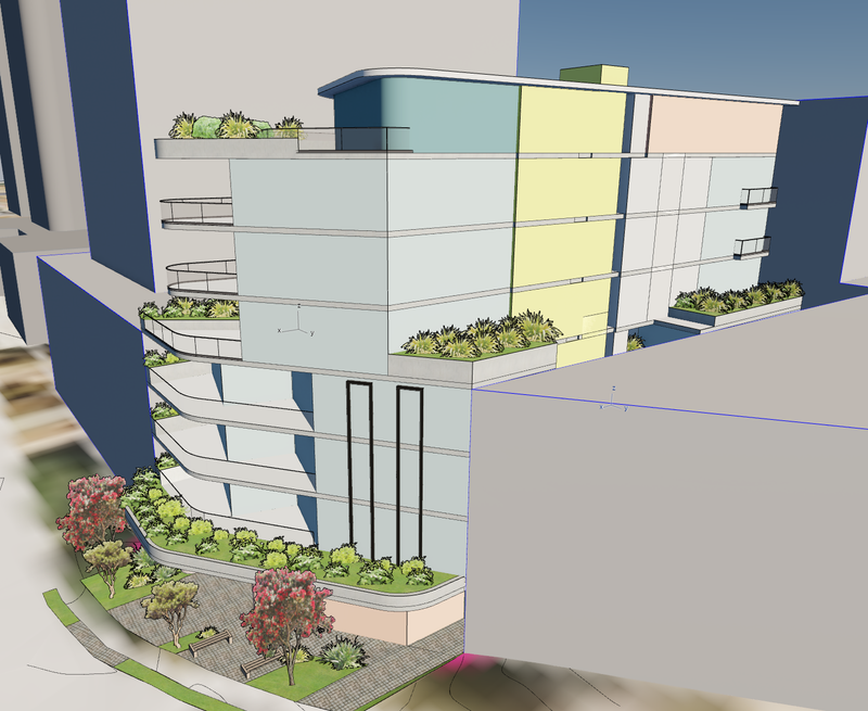

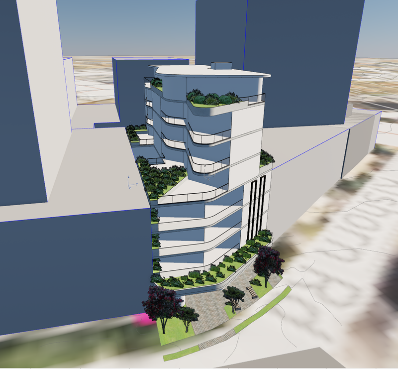

Anyone out there does Stack models for quick feasibility studies?
I am sure there are plenty.
For something like below, the last thing you need, is to draw walls and slabs and roofs etc.
All you need is Volume and Space.
Why? Because at the early stage the model needs to be simple and nimble. Something easy to modify on the fly.
In order to do that, the less elements you have, the better.
Still, you would want to be able to get information out of the model, like:
  • Total Number of Apartments
  • Number of 1, 2 or 3 Bed units
  •  Gross Floor Area, Net (at least calculated) Floor Area
  • Breakdown of areas per Use/Category
  • etc
Also, sometimes you would want to do some colour-coded 3Ds right?
The Zone tool would be the logical solution to do these tasks, but:
  • We can't have associative dimensions to Zones
  • We can't Group Zones
WHY??????
Just because of these fall-backs, I use slabs instead. That is not very intuitive, is it?

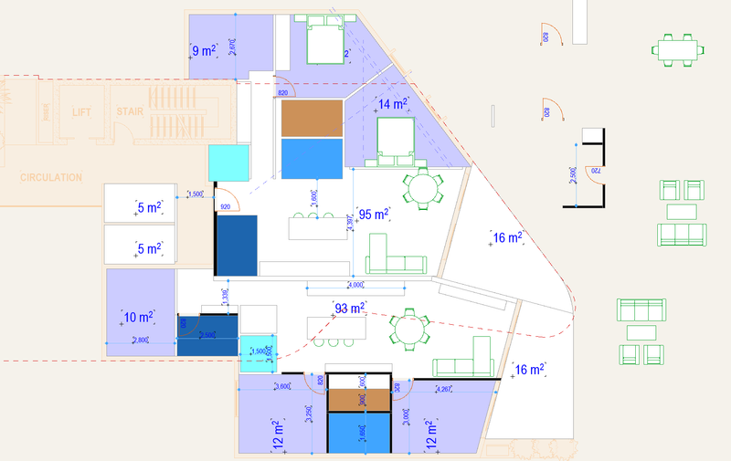

Another use case for Zones, where grouping and dimensioning would be great to have is at space planning.
I personally do not design walls to start with, I design spaces.
Walls are just drawn in once the space planning is settled.
Like in the below sketch phase, when things are a bit all over the place, but coming together for space planning.
Again, dimensioning and Grouping zones would be an easy answer, but no, I have to use fills or slabs instead and turn them into zones later...
Yes, I understand that my design methods may be a bit unorthodox, still I find it would benefit many users if Zones were not an afterthought (Annotation), but a Design Tool.
