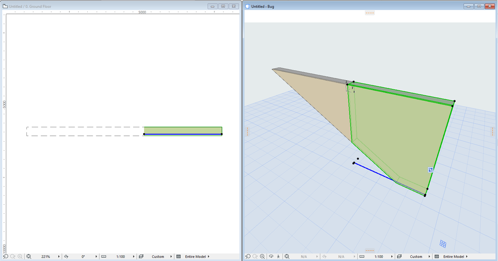

AC doesn't show SEO's in plan. What you could do is simply split the wall along it's length and adjust the base height of the upper section to be above the cut plane. It should then display as overhead lines. The SEO's can still be applied for the 3D / section drawings to show correctly.

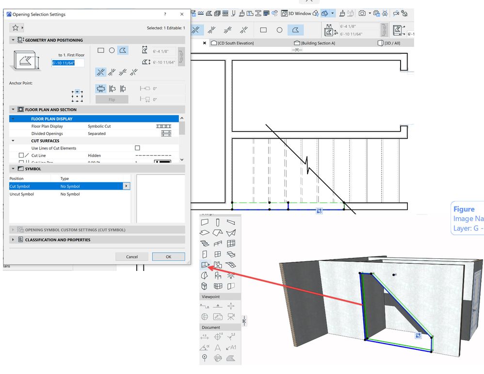

oh yes. Very common situation.  I think you will find that just putting an opening in that wall below the stair will do the trick.
proto
how does that work in elevation/section?
Mac ACv29.2.0/5003, US, Tahoe26.5.1, 2021 iMac//2023 MacBook Pro//2025 Mac Studio
Steve Jepson
it works just as expected.  You can adjust and change that kind of opening in a section, elevation, 3d view... just mode the nodes of the opening to where you want them.  https://www.youtube.com/watch?v=YbNA8G8vBUU

proto
thank you for the explanation, but esp the picture & YT link
i get it now

Another method would be to split the Wall in two at the point where the floor plan cutting plane intersects with the lower surface of the slanted cut in the Wall (you can find that point in an Elevation parallel to the Wall), then display the above-cutplane portion as an overhead element, using dashed lines.

ok, i'm still not getting the dashed overhead line.
I created the opening.
In the Opening Selection Settings, I chose:
- chose "No Symbol" for both the Cut & Uncut Symbols.
- changed the linetype of Cut Line to be Hidden
[edit] I changed the Contours on Open Edges to be "Show as Overhead". Now the opening is showing as Hidden in plan view
