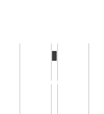

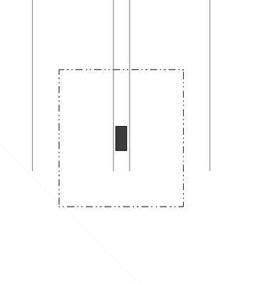

I would like to hide displaying of upper parts of a segmental column. But I don´t want to use the properties window, because in some floor plans I need it to be visible and in some not.
I need it to be displayed as this.
Could you please help me?
Thank you
