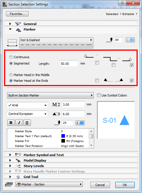

You can do this using a Source Section Marker and a Linked Section Marker.
Place the Source Section Marker and make it as long as you need in the Section View. Then in the Marker panel of the Section Settings Dialog select the Marker Head at the Ends radio button and uncheck the side you don't want to see (e.g. the left side). Also, use the Segmented radio button and leave only the side you want to see (e.g. the right), also define the Section Line Length you want to see.
Now you have one side of it.
Now you can create another Section Line for the other side, but you should select the Linked Marker option for that in the General panel and link it to this Section (this way that Marker will be linked to this Section and will not create another Section Viewpoint).
