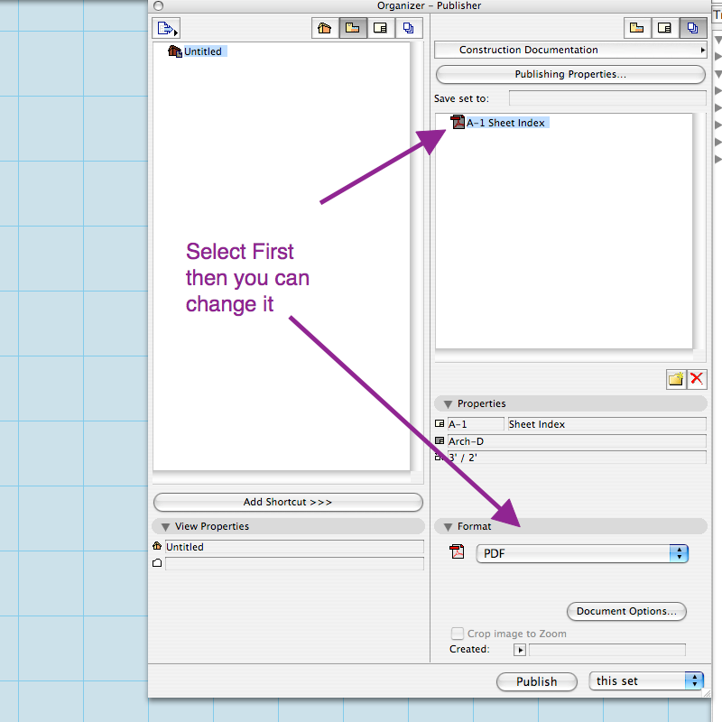

I cannot print to a pdf file. When printing the pdf option does not show up. Under print set-up the pdf is not there but "temporary ArchiCAD10 publisher" shows up. If I try to use that it only stalls out and nothing happens. What do I need to do to change it back to pdf?

In AC10 the process for creating .pdf's changed. New new way is to publish (layouts or model views) from the publisher tab on the drawing organizer. After dragging the desired drawings into the publisher list you then select the output format, in this case .pdf. As an additional option you can have multiple layouts/drawings merged into a single .pdf file.

Part of the problem is that once you put the drawings into publisher and select output format - the option for selecting .pdf is not there. I cannot print to the .pdf format in the publisher and I cannot print in ArchiCAD to .pdf.

Had some luck. Reinstalled ArchiCAD on the computer. Whatever was causing the problem went away. ArchiCAD reinstalled the Amyuni PDF converter and it is now showing up when I go to print from the desktop and when I use the publisher.

Next time you need to only reinstall the PDF driver. Its intaller is located within the ArchiCAD folder.

Look for a folder name similar to this:
C:\Program Files\ArchiCAD 10\PDF Converter\Install
