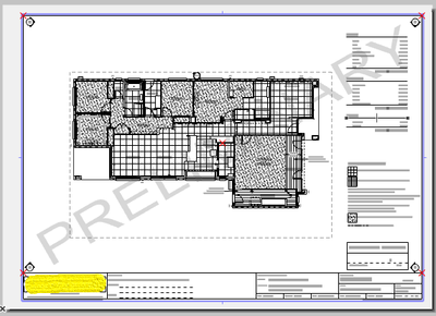

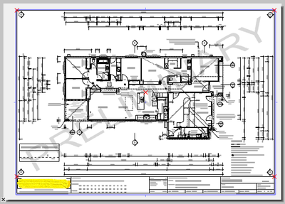

hey all.
so i have been searching for some time now to have the best practice when it comes to placing watermarks on preliminary drawings but it seems nothing work.
-if i put watermark in master layout its appearing behind the views and i cant bring it to front. (fills and zones )
-copy watermark ontop of each layout is taking me some time (i have around 40 sheets)
-i created the watermark using 3d text and then explode
so i was wondering if there is a way to place the watermark as a view on the layout but placing the view on all layout in one go.
this is an example of how my watermark should be .

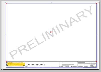

Layouts
blow up of layout with fills in it, text over top.
Master
Master Setting
you can redesign the master so it doesn't have fills in it
then
Display Master Layout "Above Layout"
that is how we use it
yes, we did the 3D text, explode then turned into 25% transparent fill.
that was then saved as an object for latter use.
