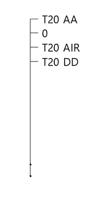

I'm making a label for Finishing materials.

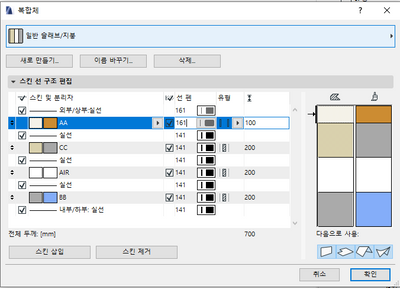

there is a problem to solve that I want to skip the value named AIR but i don't know how to skip it.
For example, in this picture Even if the slab contains 4 materials, I don't want to label the material named AIR.
this is the scripts i used.

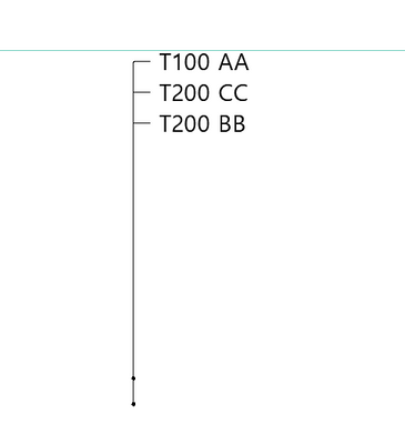

I want only three expressions: AA, BB, and CC on my label.
Like this picture.

I tried add some loop on script as someone adviced me before
but it still put "air" or "0" on the screen.
I want to SKIP the "air" line.

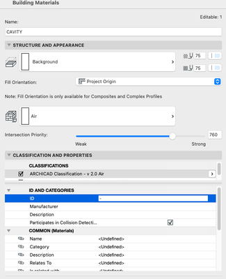

You could also try utilising ID field of building material. For instance the ID of building materials you want to hide could be set to "-" and in the script you can request building material ID and set it to do nothing if ID is "-".
n = REQUEST{2} ("Building_Material_info",n = REQUEST{2} ("Building_Material_info", name_or_index, "gs_bmat_id", MY_MATERIAL_ID)

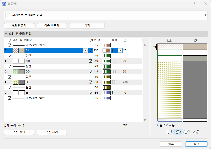

Hello I want to remove a specific value from an array.
For example, if the Label object can show Material Thickness and Material name togeter.
I removed only the "air" layer to don't display it on screen.
I asked before twice in this board.
but the info i got last time, it just shows the value as 0, but I couldn't get rid of it.
i wanna make this label which can remove "AIR" row automatically.
I attach my file below.
plz let me know how to solve this problem

GDL doesn't have the equivalent of break/continue in other languages.
It would be simpler to add a condition where you are displaying the data with TEXT2.
Or you need to be creative with goto:
output = 1
for input = ...
    if MATName[input] = "AIR" then goto "nextMAT" ! skip input
    ! process input
    autotext[output] = ...
    output = output + 1
    "nextMAT":
next input
