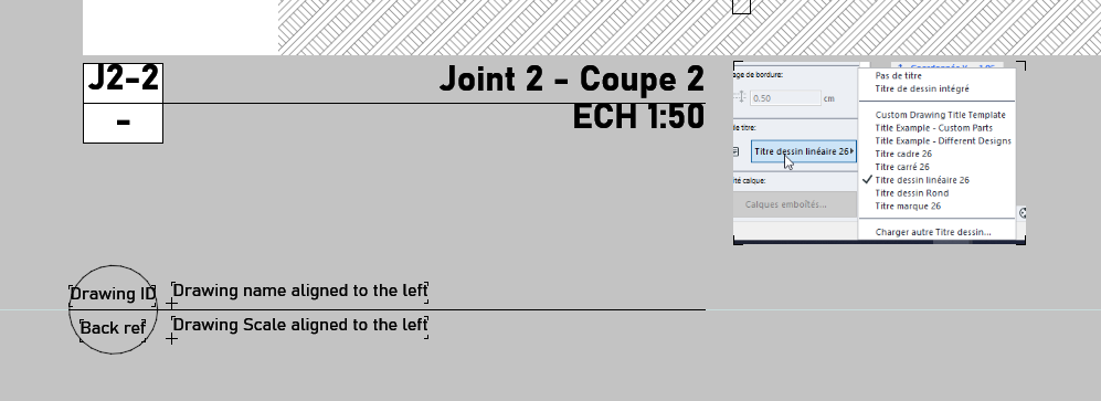

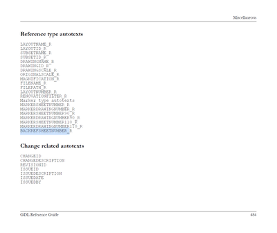

Hello ,
Creating custom drawings does not support back referencing,
the defaut Archicad linear drawing title object support back reference, but i don't know why  this object is designed to show titles and scales on the right of the drawing,
i know it can be adjusted inside the GDL editor, but i didn't figure it out, i tried but with no results,
Can someone help me to obtain that result by editing an existing drawing title GDL script ?
Thanks

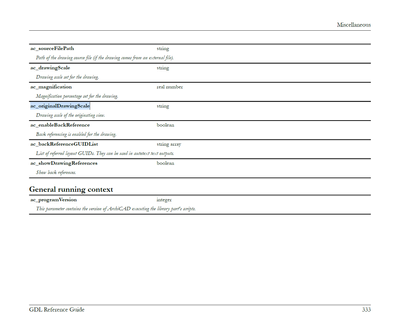

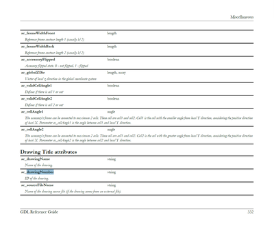

(Note: the AC_BackReferenceGUIDList array produces ID of the drawings so it can calulate the page the backrefence is on, you need lots of extra parameters in the parameters script for this to work)
to get the drawing name and number in code then
drawingNumber = gs_drawing_number_prefix + AC_DrawingNumber
text2 posX + gs_drawing_number_pos_x, posY + gs_drawing_number_pos_y, drawingNumber
drawingName = AC_DrawingName
text2 posX + gs_drawing_name_pos_x, posY + gs_drawing_name_pos_y, drawingName
(Note: the AC_DrawingNumber and AC_DrawingName parameters need to be in the parameters script for this to work)

(Note: the AC_OriginalDrawingScale and AC_DrawingName parameters need to be in the parameters script for this to work)

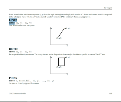

you would need a circle,
you will need a line
and you will need to set anchor points to the text
the code  that Archicad produces will look like this.
the anchor points i will make bold, in the textblock part of the script:

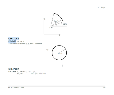

line2 -0.005, 0, 0.065, 0
circle2 0, 0, 0.005

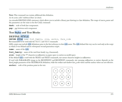

define style{2} "Arial_STYLE_2mm" "Arial", 2, 0!!!2mm Arial text....you can change this,
set style "Arial_STYLE_2mm"

"<BACKREFSHEETNUMBER_R><DUMMY><.>" + AC_BackReferenceGUIDList[1] !!!!!!!!!!!!!!!!!!!!!!!!!!"Back Ref"

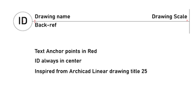

Thank you so much for your time and effort !!
last week i spent a day to understand how the linear drawing title object works ,
after a looot of headacke i modified the defaut object and it looks exactly like i want, the edited script is close to yours,
i'd like to test your method and see what i get !
thanks 😄
here i share with you the object i got agter editing ,
