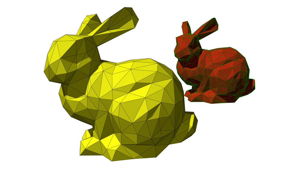

Not a pyramid:
In conjunction with a blender script (I did us chatgpt for that)
import bpy
# Output file path
output_file = "C:/Users/potato/mesh_data.txt"  # <-- change this
with open(output_file, 'w') as f:
    vertex_count = 1
    face_count = 1
    for obj in bpy.context.selected_objects:  # or bpy.data.objects for all
        if obj.type != 'MESH':
            continue
        mesh = obj.data
        #f.write(f"// Object: {obj.name}\n\n")
        # Write vertices
        for v in mesh.vertices:
            f.write(f"points_s[{vertex_count}][1] = {v.co.x}\n")
            f.write(f"points_s[{vertex_count}][2] = {v.co.y}\n")
            f.write(f"points_s[{vertex_count}][3] = {v.co.z}\n")
            vertex_count += 1
        f.write("\n")
        # Write faces
        for p in mesh.polygons:
            # Ensure we only handle triangles or quads (can expand if needed)
            verts = p.vertices
            for i in range(len(verts)):
                f.write(f"faces_pi[{face_count}][{i+1}] = {verts[i]+1}\n")  # +1 for 1-based indexing
            face_count += 1
        f.write("\n")
print(f"Mesh data exported to {output_file}")
