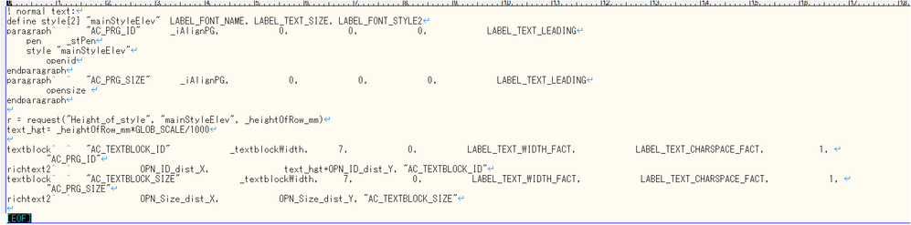

I created a label using textblock and richtext2.
Is it possible to freely move the part specified in the textblock with hotspot2?
It doesn't resize the text block, just move it where it's placed
Another method is to prepare two parameters (X direction and Y direction) to specify the distance you want to move.
I would like to know if it is possible to move freely with hotosopt2.

Attached is the script.

to move freely an element created in gdl you  have to blend 2 hotspots together :
uid = 1
HOTSPOT2 -1, 0, uid  : uid = uid + 1
HOTSPOT2 1, 0, uid    : uid = uid + 1
HOTSPOT2 hotspot_x, 0, uid  , hotspot_y, 1+128  : uid = uid + 1
HOTSPOT2 hotspot_x, -1, uid  , hotspot_y, 3  : uid = uid + 1
HOTSPOT2 hotspot_x, hotspot_y, uid  , hotspot_y, 2  : uid = uid + 1
HOTSPOT2 0, hotspot_y, uid  , hotspot_x, 1+128  : uid = uid + 1
HOTSPOT2 -1, hotspot_y, uid  , hotspot_x, 3  : uid = uid + 1
HOTSPOT2 hotspot_x, hotspot_y, uid  , hotspot_x, 2  : uid = uid + 1
where hotspot_x and hotspot_y are the x and y coordinates of the hotspot you'll use to move the textblock

Thank you JulienK
I think hotspot_X, hotspot_Y are local coordinates.
If hotspot_X and hotspot_Y are set with the world coordinates imported by the add-on, is it possible to move the text in the same way?
Is it possible to move the text written in world coordinates?

I am making a label for the opening with GDL.
Mark the opening with an X and draw the dimensions and ID near the opening.
I would like to move the label for that dimension or id with a hotspot.
The shape of the opening (whether circular or rectangular) and the positional information of the opening cannot be known without an add-on, so I created an add-on for that purpose.
Right. So you place label on a window, door or opening, and it will create a cross on it then read the ID as well as retrieve the dimensions via your add-on to be displayed at a user determined location that can be modified via a Hotspot.
Following the Hotspots created like how Julien as explained, you then use the same hotspot_x, hotspot_y to place your Richtext.

GDL hotspots always work with local coordinates, the origin is the object's origin.
The conversion to plan coordinates depends on the tool with which the library part works. In the case of labels use LABEL_POSITION[1][]
If you need to display coordinates to the user, GLOB_WORLD_ORIGO_OFFSET has to be added to handle cases when the plan contains large coordinate values.
