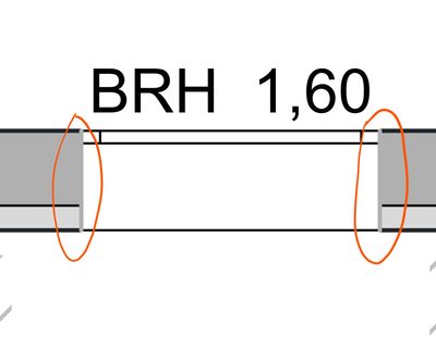

maurotrotta
I think I have a basic question but can´t figure it out. I have a window in a wall, but can´t make the window side lines to look how I need. There are some pen displaying that I can´t find if it comes from the wall settings or the window settings. I have check both without succes.
I notice the edges of the walls also display the same pen color than the window opening, still I don´t understand where can I change this setting. Can someone tell what I am missing?

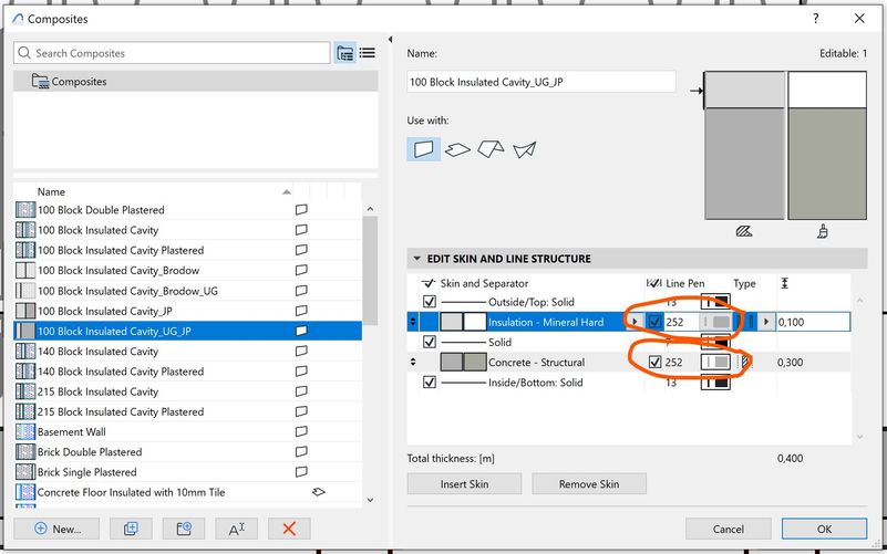

maurotrotta
For those having similar issue, I just find out that the composite of the wall was controling the display of the wall. See the pic attached.
