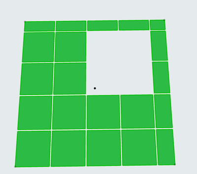

3D-PRISM_ How to define tiles and holes? To avoid excessive clipping? I am a GDL beginner. GDL treats the entire outer frame as a hole, causing the whole piece to disappear

if you are just wanting to cut the hole, you can use
SOLID GEOMETRY COMMANDS

this will just take the tile and do a big "Solid element operation" cut from them
Is this the sort of thing you are after?
2026-06-06 10:58 AM
I'm very sorry it took me almost four weeks to reply. The 2D and 3D code you provided was very helpful and gave me a lot of direction; it was invaluable because I couldn't achieve the compensation effect when cutting blocks and tiles. Thank you so much!
You understand what I'm trying to express!
