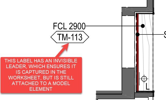

  7. Inclusion in Worksheet when outside Worksheet border (a la detail crosshairs): Granted, this is a bit more obscure, but still has a real-life use when combining labels in a 'stack' but only using a leader on the first label (see attached image).

  7. Allows for a separate line type and pen to be used for the frame, so the leader line can be 'hidden' with a white pen and wide-spaced dot line type.
