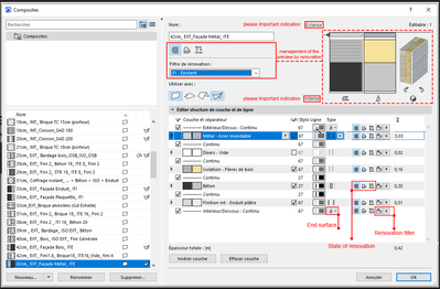

abdelaziz
Hi
Here is a small representation of what I understand
abdelaziz_0-1667041666427.pngabdelaziz_1-1667041692480.pngabdelaziz_2-1667041722591.png

DGSketcher
Legend
@abdelaziz Good presentation!
Personally I don't think it should be possible to override the Building Material Type of Core etc. It is that kind of overly flexible thinking that has lead us to the  complexity of dialogs we now have. No one is asking for a "by element" override on other attribute aspects, so why can't the Type be fixed?
We need to think about new users as well as our own knowledge of AC. If something isn't displayed as expected then where do you start to explain or track down that Concrete isn't being displayed as a Core material as someone accidentally changed it in the Composite Wall to Other.
abdelaziz
@DGSketcher
thank you for the remarks which I find very interesting
the problem with the use of the "Component type" option in the menu of the building material manager only, forces us to create 3 times the same material for different Types of component, I think it would be possible for Graphisoft to find us a solution that would allow us to verify the use of personalize component types even if it will not be in real time as with attribute manager
and we need this flexibility, the material does not have to represent a function, the introduction of the Component type will serve us more to make things predefined by default
