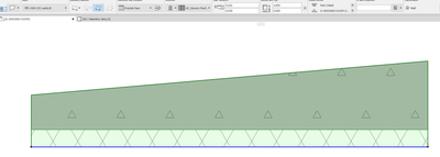

4.4 Slab Composite and Slab General
please let us model slabs like these
The wall tool (Trapezoid) does it, why not the slab?
+if i morph the wall then all but one building material will be forgotten
it would be better to break up each skin into a single morph then the building mat. would be preserved
