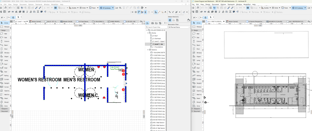

No fonts only models like a toilet from one 29 project to another
Wednesday
NOT really. I open a file in a new version and and have a lot of dots where any object like a door is.
I do this as I want to copy common items into a new project and have to start all over again

Migration between versions is something else than using a file on different operating systems – which was the topic of your post 😉 Barry is not psychic yet.
To give you a good answer you'd need to tell us more though please: What (old) file version are you opening on what (new) Archicad version?

If the source file was created in a version 27 or older you will have a problem with objects if you copy and paste to 28 or 29, unless you load the old monolith library and migration libraries.
Element such as walls, roofs, etc., will copy and paste just fine.
It is only objects you will have a problem with because as mentioned before the libraries in 28 and 29 use completely new objects that are not compatible with the old ones.
The old ones will not migrate to the new ones.
If you have old objects, you need to load the old libraries as well.
There are many post in these forums about the old and new libraries changing between versions 27 and 28.
It is recommended that you don't mix the old monolith libraries with the new library packs.
It will double up on the library objects themselves and also double up the Model View Option controls, one set for 27 and another to control 28/29.
I have even made a wish that Graphisoft creates an 'Obsolete' library for the old 27 library.
This would allow you to still see and use the old objects, but you could only ever place new 29 objects without having the double up of old and new library.
Obsolete objects is how they used to handle outdated objects in the past (and still do I believe) when they can not be migrated to current objects.
https://community.graphisoft.com/t5/Wishlist/27-Obsolete-library-for-28/idi-p/636043
In my opinion, if you need to copy and paste from old files to 29, that is fine.
Just replace the missing objects with the new 29 objects and move on.
You will have no problem with these files moving forward (unless Graphisoft change the way the library works again).

I just tried this . Opened a project that was fine all 5 years. opened in current version and black dots everywhere, no doors, no toilets, no urinals, etc. I have to relink every one

The libraries changed a couple of years ago in version 28.
There is no migration of libraries 27 and older to 28 and newer.
They are completely new objects in 28+ and will not work with older files.
So if you have an old (say version 25 file) open that in 28 or 29, but do not load the new libraries.
Keep using the old 25 library.
Or you could load the 27 library and the migration libraries as well.
Do not try to use the new library packs for 28 or 29 unless it is a new file created from a template in 28 or 29.

Left is new Project and Right is old project

I’ve not seen anyone talking about moving your projects between platforms via archive/PLA, which will include all used library parts in the PLA and allow you to continue, at least in the same version of Archicad on the Mac as you were using on the PC. I wouldn’t bother trying to
migrate an existing project to a newer version of Archicad unless it is something that will continue to evolve for years to come. Finish it in the version you started in and set up a template in the newest version of Archicad for new projects.
