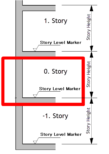

Stories in Archicad, just as in real buildings, serve to divide space vertically and replicate the story structure of your real building.
Stories are ranges of height in space. Each story has a reference (level). It is the height of the horizontal plane at the bottom of the vertical range. The references of the stories are represented by Story Level Lines on Sections and Elevations.
