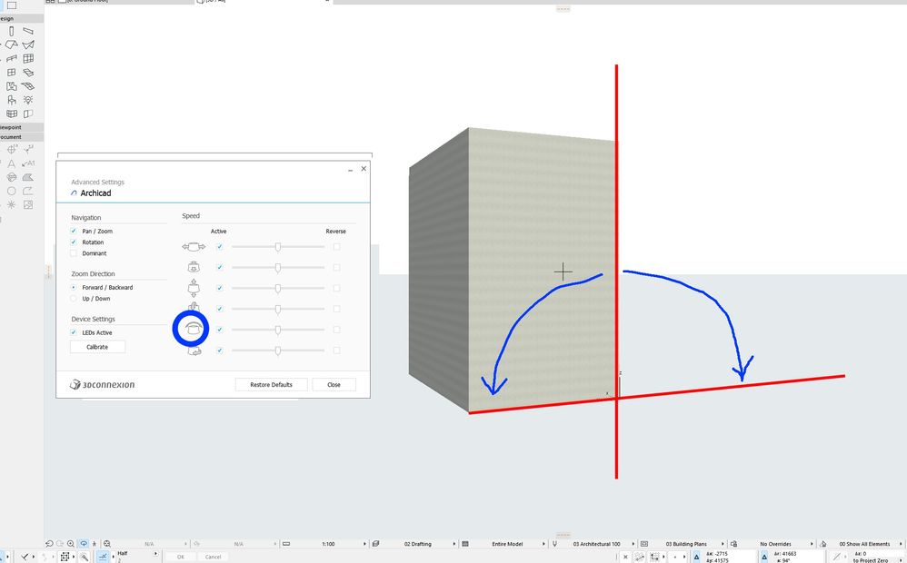

2024-03-21 02:51 PM - edited 2024-03-21 03:06 PM
AC27 is the Windows version,
Does the Space Mouse rotate left and right with respect to the z-axis?
I can't do it on 3d Windows and BIMX.
Is there any other solution?
2024-03-21 03:12 PM
Hi Matt,
I've got two of the 3DCONNEXION Space Mouse, one wired, the other wireless (with the 7-button programmable mouse as well). No problems with either setup on Archicad 27. Although, when I first connected the wireless one it worked for a moment, then got stumped (most movement was gone, and what was left was erratic), so I just went into macOS Settings and clicked the Use Defaults button at bottom-right. This sorted everything.
Have you tried that?
2024-03-21 03:15 PM
It's the Windows version
It works well with other 3D programs.
