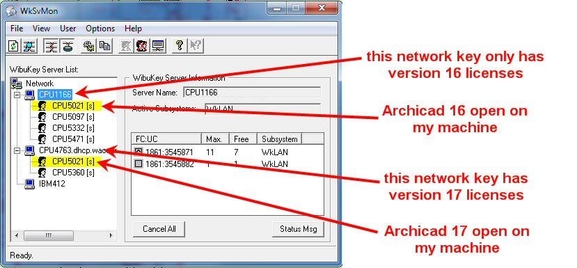

I have done a little experimenting while most users were not logged in.
As mentioned before I have multiple network keys - 2 have been upgraded to version 17 licenses and the rest are version 16.
When I start Archicad 17 on my machine it logs into the "17" network key.
At the same time if I start Archicad 16 it will not log onto the same key but searches out a key with the 16 licenses on it.
Previously different Archicads would all log onto the same network key (room permitting).
Should the "16" key be full then it will use the "17" key but I am wondering if this is why we get the "quit and save" message as it is really not wanting to be using that "17" key.
I myself don't seem to get this "quit and save" message but I have version 17 installed and therefore the WIBU-key software and drivers are all version 6.1 as supplied with the 17 installation.
The other users in my office are all on 16 (17 has not been installed on their machines) so don't have the latest WIBU drivers and maybe this is possibly why they get the error message.
