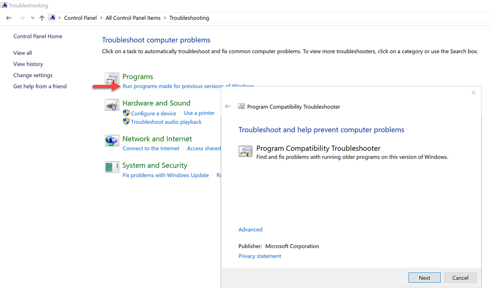

Be careful that the card is out of date enough to run ArchiCAD. I just bought an Nvidia P5000 16GIG GPU card and everything looks very very good - except ArchiCAD - to fuzzy to work with at any resolution I tried. This is probably because ArchiCAD is using OpenGL 2.0 and my new card it 4.5 ?
I have the card to use with GPU Rendering in Maxwell, I am hoping there is some way to configure the card to make ArchiCAD look better. Its a shame not to be able to run ArchiCAD on this Workstation. 64GIG of ECC, Xeon E3 1535M, 3840x2160 super high quality screen... too much for ArchiCAD I think. ?? I hope there is some way to configure my card for ArchiCAD too.
Any tips?

I am getting closer to a tolerable ArchiCAD screen, but I still can't manage to make it a clear as all the other programs. There are two way to control screen quality and resolution. It takes a lot of trial and error to discover what settings to what to the quality of the screen image.
NVIDIA cards come with some pre-configured settings for other CAD programs, It would be nice if there were something like that for ArchiCAD too. Just some basic tips on what will and wont have any effect on ArchiCAD would be helpful.
I think the best I can do will be to set the resolution to 3840x2160 then rescale the screen 225 -250%.

Steve Jepson
Yes. My Dell M6600 is 1920x1080 and ArchiCAD looks great on that.
However, I needed to get a new computer that has at least 64GIG of RAM, the fastest processor and GPU graphics card I can afford. That worked out to be a Dell 7720 Mobile Workstation for me and it came with a hi res screen - 3840x2160.
I think I have found a very simple solution. I ran the Windows 10 Program Compatibility tool and have it looking a lot more like what I want.
Steve Jepson
Yep. That was all there was to it. Run the Windows 10 Troubleshooter until you see the results you want. ArchiCAD 21 looks fantastic on this screen.
17.3" UHD IPS Narrow Border (3840x2160)
I wonder if everyone using Windows 10 should do the same thing. You might be surprised at how much better ArchiCAD can look on your screen. ? It can't hurt to check it out.
This may also be due to a new improvement in the latest version of Windows 10 which I think was out today.
