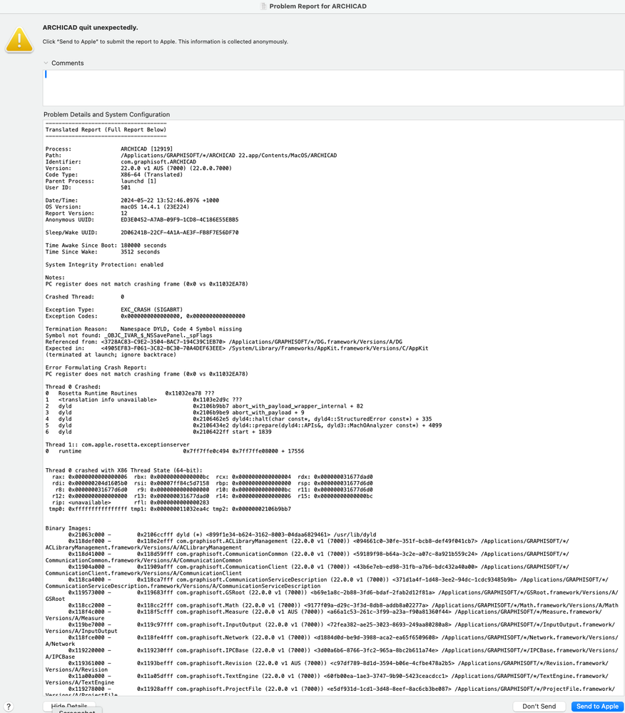

ARCHICAD 22 quit unexpectedly. on macOS 14.4.1
Craig yelland
When I start Archicad it immediately shows "ARCHICAD 22 quit unexpectedly." and doesn't open.
This just started to happen.
I reinstalled archicad and the licence manager. same result.
Same thing happens on my iMac and my 2022 MacBook Pro.
any ideas?
Operating system used: Mac Intel-based 14.4.1 Sonoma

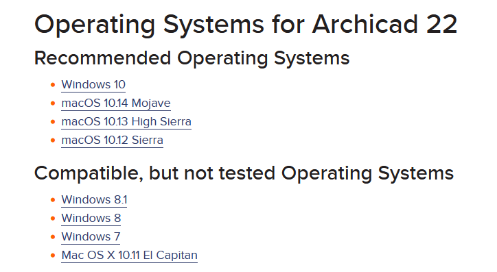

I am not a Mac user, but does 22 run in OS 14.4 ?
Maybe it did but you have just had a recent upgrade that broke it?
When I look up 22 requirements it says it runs on OS 10.11/12/13.
Solution
Sefa Yakut

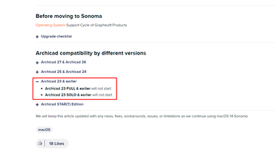

I'm sorry but you can't run Archicad 22 in MacOS 14.
https://community.graphisoft.com/t5/Installation-update/macOS-14-Sonoma/ta-p/385787

Unfortunately archicad 22 doesnt work on macOS 14. it worked on OS 13.
