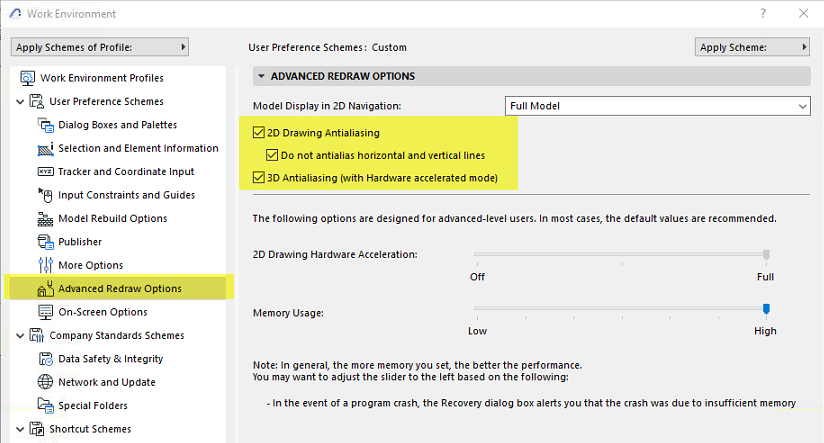

Also check your Advanced Redraw Options in the Work Environment.

Work environnement : I have disabled 2D and 3D antialiasing options.
