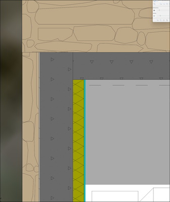

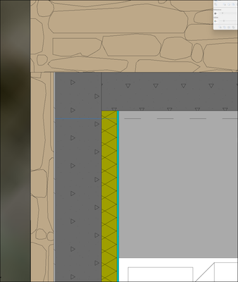

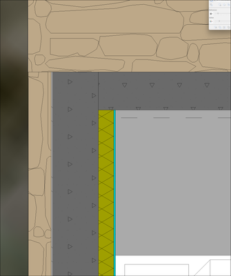

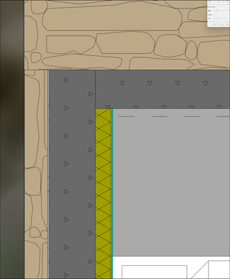

So I gave one more try and reverted back to the OPENGL API.
It seems that the antialising performane of DirectX is far more better and the graphics are far more clearer. I have been working with DirectX API since the beginning of 27 (In 26 there was a serious problem with text fonts so I had enabled the OpenGL API) and now that I tried for once more the registry fix I realised that texts and lines look much clearer and detailed with DirectX.
I guess this improvement has a performance cost.
OpenGL gives thicker lines. I prefer the DirectX API. Maybe I got used to it....
OPENGL NO ANTIALISINGOPENGL NO ANTIALISINGDIRECTX NO ANTIALISINGDIRECTX NO ANTIALISINGOPENGL WITH ANTIALISINGOPENGL WITH ANTIALISINGDIRECTX WITH ANTIALISINGDIRECTX WITH ANTIALISING
