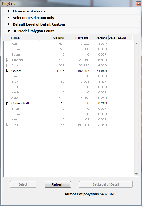

I have a performance problem related to skylights. We have reported the issue through our distributor but want to know if it is happening with others also.
Performance drops when I have over 1000 skylights in the project in both AC 19 and 20.
When there is a huge number of skylights all window and door operation (and some other 3D element operation) in 2D and 3D becomes very slow.
No matter on which story you are working it is very slow.
No matter if you make all skylights empty openings it is still slow.
Hiding the layer of roof or deleting the skylights returns performance to normal.
The model is huge, there is a big number of polygons but problem only comes when I introduce skylights.
In empty project creating 1000 skylight does making but only a small difference. I have 443000 polygons in 3D with all object 3D turned off (where possible).
Building is ~100m x ~300m
I have deleted all SEO.
Please check the video I have made about the issue. VIDEO

I have one guess.
If you go to the Options\Project Preferences\Legacy Dialog and check the "Use Symbolic Display in Floor Plan for Single-plane Roofs and their Skylights" checkbox, does that help? If this checkbox is not checked the 2D of Roofs and their Skylight are generated from the 3D as a true vertical projection. With over 1000 Skylight this may become a problem.
Thanks it worked!
