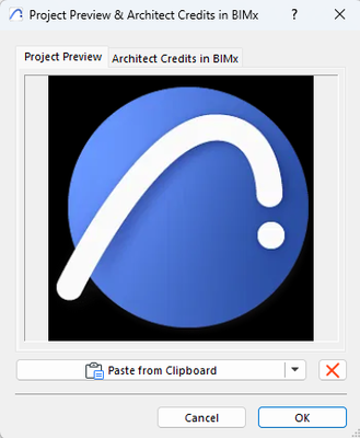

Lingwisyer
Guru
If you are not already utilising it, you could set the AC version logo as the Project Preview.
Ling.
LukaS
Yes, the suggestions above are helpful (we also started saving filenames with AC number), but all require additional manual step, which should not be the case.
I’ve tried to create Quick Action with Automator, but heuristic .pln file scans/scripts gave no reliable solution.
I think it’s more of a macOS problem, but was hoping Graphisoft could do something with files so Spotlight/Preview could read more metadata.
Mac Studio 2023 (M2 Max), macOS 26.2, AC 28/29 (Silicon-based) INT
Lingwisyer
Guru
I made it part of our template for each version of AC we use, so I only do it once each time we want to start using a new version. But yeah, given the file version is visible to the OS, I wish it would automatically use the correct AC version, rather than always needing to "open with"...
