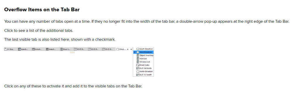

Having a large number tabs open in a project causes the cursor to show the processing symbol in menus and flicker between the normal cursor and processing symbol in dialogs/dropdowns. In addition to this - it is not possible to consistently add criteria to F&S/GO or criteria and field to schedules by double clicking in the list.
It seem to happen around 28 tabs and it seem to be the number of tabs rather than type or content. E.g 28 tabs with empty 160x120 render output images (static and less than 2kb each) causes it. It is admittedly a lot of tabs but not that hard to hit, especially if you do internal rendering while working and thus get a lot of 3D model pictures. Guess it is an additional reason for a render output manager.

You can set it in your Work Environment so you can only open one view (tab) of each type of view (elevation section, detail, layout).
But is is either just one or many, you can't specify a specific maximum number.
No - having more tabs than fits on the bar is simply not a question of missmanagement. The reference documentation even states that any number of tabs can be open at a time. It would be understandable that a large number of tabs would slow down the application but that is not the issue here. The issue is that something seem to happen around a set number of tabs - are we to read the documentation as: you can have any number of tabs open at a time as long as it is less than 28?
