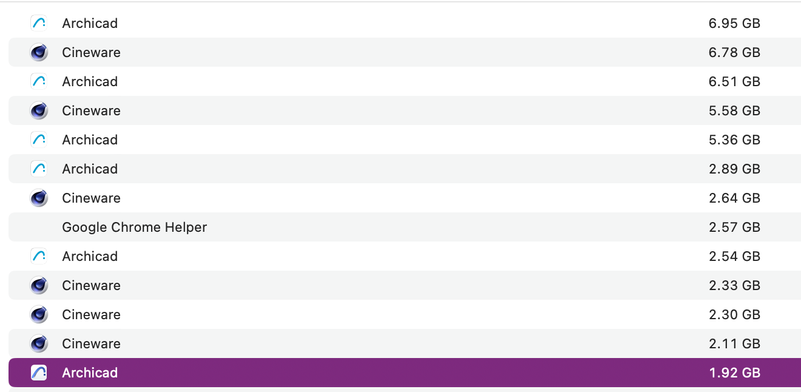

@Eduardo Rolon maybe it is a memory issue... I have 128GB physical memory, and typically have 75+GB free. But I have seen Cineware eating up massive memory caches (even though I never use cinerender). I think I posted about this years ago when my older macs were routinely running out of memory with only a few AC files open, a nd I'd see Cinware taking up 5-10x more memory than Archicad. Doesn't look like its that bad on my compy now:

Eduardo Rolon
This one is a mac only issue and I don't think GS can do much about it because of TW.
