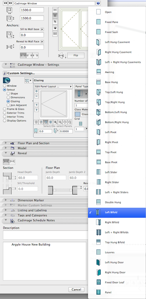

These are the options you have for any panel in a Cadimage window…
Jealous much?
Jealous much?
