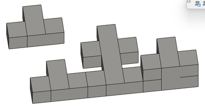

It already works, Barry. You might have missed it, it's in the newer commands.
As an example look at cprism_{3}:
That is fine for adjoining CPRISMs in the same object.
But if two of those objects touch each other, they will not blend together.
Did you actually try it?
Because in my screenshot is just one object, placed 4 (!) times! 😉
So yes, it works as advertised, and they WILL blend together.
This might convince you:
Works in all dimensions:
Yep I get it now.
The mask value affects the individual CPRISMs within the object as well as those for adjoining objects.
I was using the example from the GDL manual with the 4 cubes next to each other, but didn't change the mask values.
So it depends which edges of objects touch.
The mask values are for top (1), bottom (2) & side (4)  (or any combination thereof 3, 5, 6 or 7).
When corresponding masked edges touch, the join will be eliminated.
Set them all as mask = 7 and all edges disappear.
