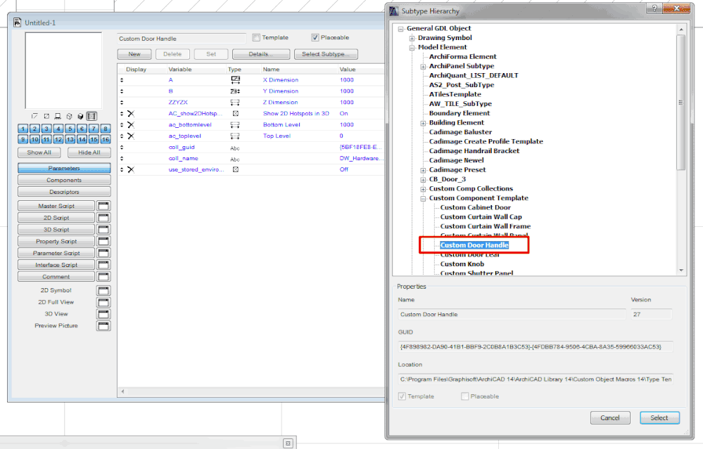

When you create your new hardware choose
Under Model Element
Custom Component Template
Custom DW Hardw Component
Erika

The handle must be created as a GDL object and placed in library, isn't it?
When creating the object, the "custom door handle" must be selected in "subtype".
And then, in Internal Door Settings > Door Panel > Handle > Custom Handle, it must appear.

If you model something, select it and use the File\Libraries and Objects\Save Custom Component command and save with the Custom Door Handle option, it should appear as a selectable option.
Maybe you could do that and later modify the 3D Script of what you saved this way.
