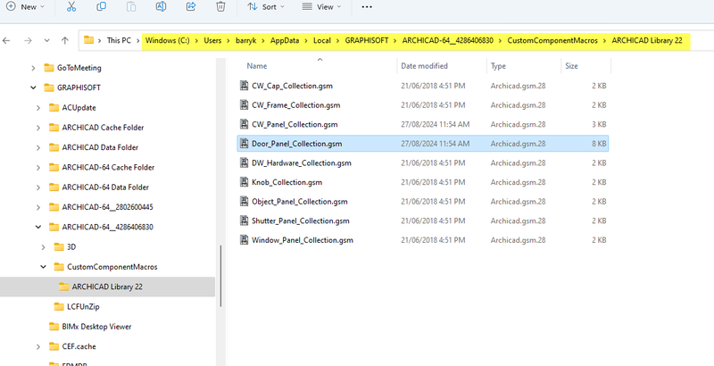

Lingwisyer
Guru
Does the Session Report say anything when you place the door?
So just to clarify, you see the custom leaf in the list but it does not show in the object?
If it is not showing in the list, then that is the file in the library that contains all of the names (I mentioned in post above) that is not updating.
I know where the file is in the library, but it is in an LCF file, so you can't just delete it.
Deleting it is fine because it will just be created again.
You could open it to see if your door leaf is in there.
This file is also duplicated in your user profile.
The problem there is, those user folders are hidden, so you won't be able to see it unless you un-hide the folder in your operating system.
I am on Windows and I just happen to have version 22 running at the moment.
For me it is here ...
Maybe deleting that file will refresh everything when you re-load the library.
