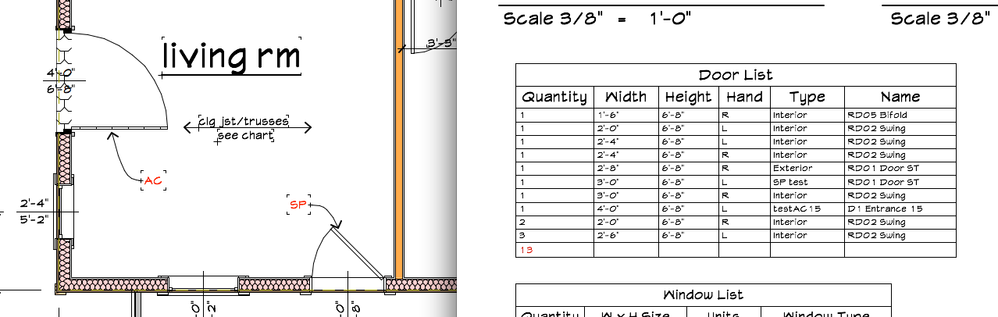

I have been doing a door schedule for years, and sent many out with no complaints. However today a builder called and told me all the "hand" designations are wrong. I know it is a confusing thing for most of us to get straight, but I assumed the computer was correct. After googling it, they all seem wrong??? I have just used the normal interactive schedule which I'll attach below.
Here is the correct answer>>>
"Stand inside the room with the door opening toward you. if knob is on the left its a left hand door. if knob is on your right its a right hand door. common sense and easy to remember!
All of these answers are right, but, for me, the easiest way is to face the door, with the door opening away from you. If it swings to the right, it is a right handed door. I think this is the simplest way to determine this. Easiest for me to remember anyway."
An AC friend just called and confirmed this huge error. All his schedules are wrong.

Scheme settings, which I don't see any control.

there is a custom orientation for opening under parameters where you can override the automatic handing which. But I can't find that field when I try to add it as a parameter. Always a user defined...Pain in the you know what.
I thought there would be a MVO to override for local differences, but didn't see it.

It seems AC, US version is set as per Australia.. according to Wikipedia.
I acknowledge I might be missing something.. but…
US = Right hand hinge (RHH): Standing outside (or on the less secure side (i.e., standing on the side you use the key on, going from outside to inside, or from public to private)), the hinges are on the right and the door opens in (away from you).
Note: In Australia, this is different. The refrigerator rule applies (you can't stand in a fridge, the door always opens towards you) - If the hinges are on the left then its a left hand (or left hung) door. If the hinges are on the right then its a right hand (or right hung)

Yep for us down under it is as simple as - stand on the side the door opens towards you and it is either left or right hinged
I am not sure if this is what Erika was referring to but if you open the object script and press the DETAILS button you can swap the handing.
The problem is you will need to do this for all your door objects and do it again if they are ever updated.

We always worked to door hardware manufacturer's guidelines, which was always from the exterior/public/outer side (for security purposes) but the handing was the side the latch/lockset was fitted to - see an example here. Thus doors were designated LHOO (left-hand-open-out), LHOI, RHOO, or RHOI. In some cases, the specification and detailing of each instance is unique.

Well, I've got a door (metal) supplier that works it this way;
If you were to stand with your back to the butts and whatever arm you would swing, would be the swing, ie the correct designation.
However my main door supplier ignores the above and any "security" issue and simply states ALL doors, irregardless of any locking, work like this;
As you pull the door towards you, if the butts are on the right, its right hand.
So the obvious lesson is there is no standard, only the standard of whatever door company your using for that door/job.
How does gs make this more user friendly, don't know, butt it would be nice.

I don't think this can be called a bug because it is just a matter of setting it up as you like it.
Here is how one company calls it. I bet there are some that show otherwise.
It is actually not always perfectly clear. I think I will start putting legend like this( when I find one I like ) next to my door schedules.
http://www.special-lite.com/files/Handing.pdf
Sometimes the bevel is also a part of the designation.
