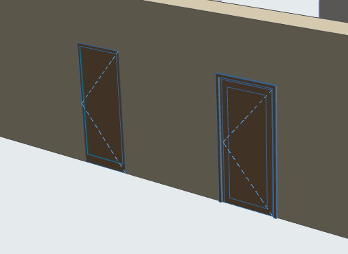

It seems like the older versions....where there was a button for all materials to be the same. I can't seem to turn it off. Have toggled the switch for uniform materials on the door leaf dialogue box....but it seems to stay on (using uniform materials). If I turn it off, I can change materials in the dialogue box but nothing actually happens to the door.

Tom wrote:In the Door Settings, check the Model panel, there is a Surfaces Override option there.

That's where the problem lies. When that box is unchecked, assigning different materials has no effect.

Tom wrote:I'm having this problem in AC21. I've got some doors that have glass, but no matter what I try, the entire door shows up like brown paint. I can't get the leaf, frame, glass materials to override, no matter what I do. In this file, the old library doors do the same as the newly inserted library doors.
I've checked that box on/off, it makes no difference. Why do we have to redoing these same things over & over? It's making me crazy!
Anybody got any ideas? Thanks in advance!

Billy wrote:I found the solution in a setting that was not only turned off/on the wrong way, but not even showing by default! Geez....Tom wrote:I'm having this problem in AC21. I've got some doors that have glass, but no matter what I try, the entire door shows up like brown paint. I can't get the leaf, frame, glass materials to override, no matter what I do. In this file, the old library doors do the same as the newly inserted library doors.
Work Environment > Tool Schemes > Tool Settings Dialog Boxes > Door Tool > Model and make it visible.
