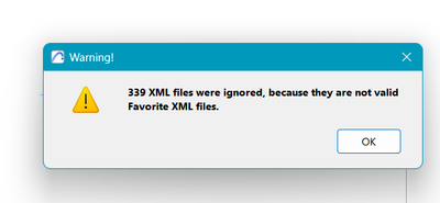

I converted them, but can't import them in 28.   it shows this.
and the convertion is I think success.
Magdolna Marosvari
Hi @Funfun Yan ,
Please take a look at the attached manual to see the recommended workflow.
Let us know if it helped.
Best regards,
Magdolna
Funfun Yan
Hi Magdolna, Thank you for your manual, it works! And I found the key is we need to use ac 28 to export AND import. The reason I failed was to use ac 27 open the file and export , then used ac 28 to import.
(ps: There will be many favorites that will not trans correctly which will need to rebuild manually.)
Thank you again. Have a good day!😀
