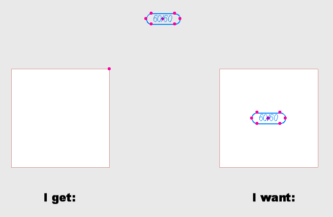

Help needed with Object Label 12
I use Object Label 12 to place information abour the size of Objects in plan, usually for cabinets and tables.
AC places it attached to the right upper corner at some strange distance from it!
I want to have it placed in the centre of the object.
Can anyone help?

I get what you want, whit Italian library.
I only have to uncheck "use symbol's arrow" in the label parameters panel.
But ... checking more, it turned out that, if I rotate the object by 180°, the label does not detect this, and I get the same result shown in your image.
And, more over, the label is really centered ONLY if the placing hotspot (origin) is in the lower left corner.

Thank you, Roberto!
I saw that with some objects the label appeared in the center, but couldn't fing why!
Alas, I walt to use the label exactly for objects with a center insertion point - lamps and switches!
Rob

your very first line in 2D script should be this:
IF label_custom_arrow THEN ADD2 label_position[2][1]+label_position[3][1]+symb_a_size/2,label_position[2][2]+label_position[3][2]+symb_b_size/2

Kliment,
the problem is:
the label anchor is ALWAYS pointed to local zero of an object. So in your case the chair has the local zero in the left bottom corner (open the chair script as check the 2D full view).
So we have to move the label along X and Y by a half of the object's size each way (SYMB_A_SIZE/2 and SYMB_B_SIZE/2 respectively)
Now if you rotate this system it does not work because when rot. angle = 0; deltaX= SYMB_A_SIZE/2 and deltaY=SYMB_B_SIZE/2, however if rot.angle=90; deltaX=SYMB_B_SIZE/2 and deltaY=SYMB_A_SIZE/2.
in other words only if you had a lib part with centered 2D view it would work. I am pretty sure it could be resolved mathematically but it is not an easy task.
Does it make a sense?
::rk
