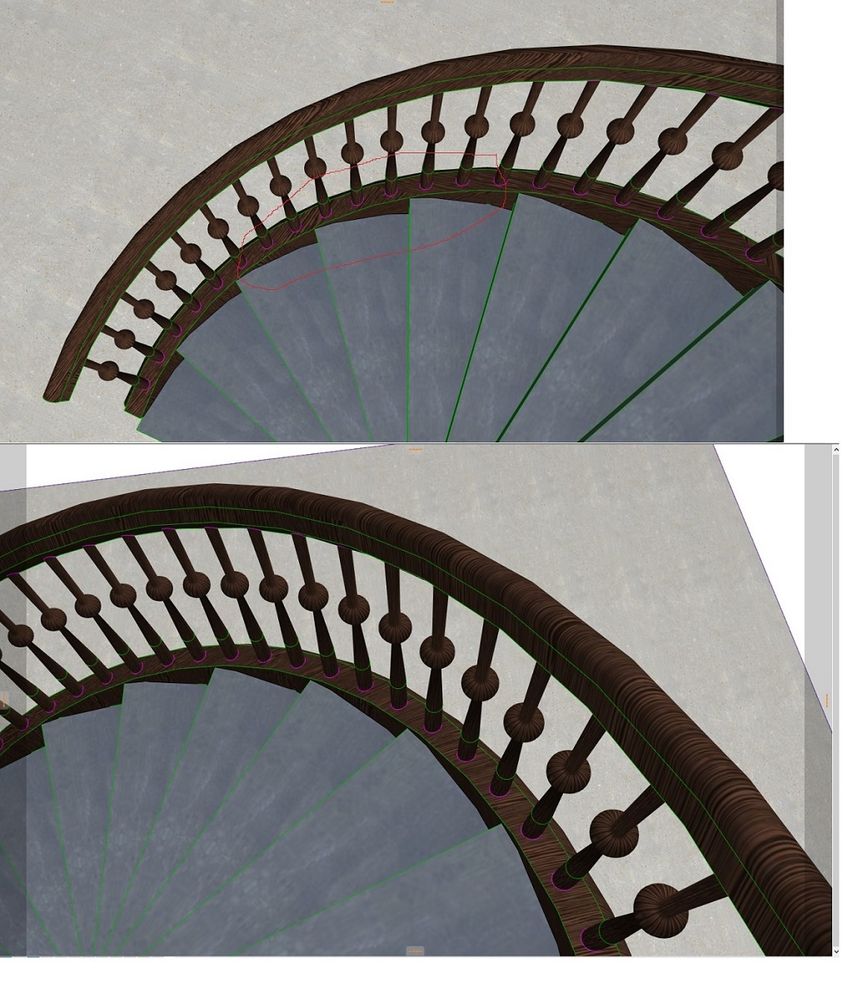

Thats what I have been using, i get close using method 4+256 but I have tried each method and so may different position locations, I dont have any issues with straight stuff lol here is a picture. the first one shows the bottom rail where the material changes direction, and the second shows what the material looks like by the time it reaches the top of the rail.

You will never have a correct map using Tube.
You must create the tube with VERT, EDGE, PGON

I see, well looks like I have my coding in for me then ha ha thank you so much for your wisdom, it is greatly appreciated.
I got it to work with the tube and 4+256
EDIT:
i have lied, it works but is still distorted on the top and bottom of flat surfaces.. lamesauce
