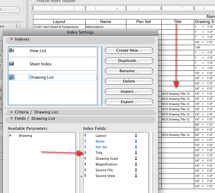

Karl wrote:I just looked through 75 layouts, for one deleted title type
If you do not see the missing texture in the materials list, then a library part is calling for it. You'll have to figure out (slow process) which part that is...
If Library Manager can find it.... I WISH "Find & Select" could.

Stress wrote:Did you try using a schedule (project index)? If you generate a drawing list and add the Title, you can see which titles are associated with every drawing on every sheet...
I just looked through 75 layouts, for one deleted title type![]()
Also, see my response to your wish/poll: schedules let you customize your search list and let you select anything in 2D or 3D.
Cheers,
Karl

Thanks Karl.
Works like a charm.
Wish I would have know yesterday.
Marc
