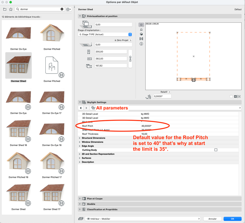

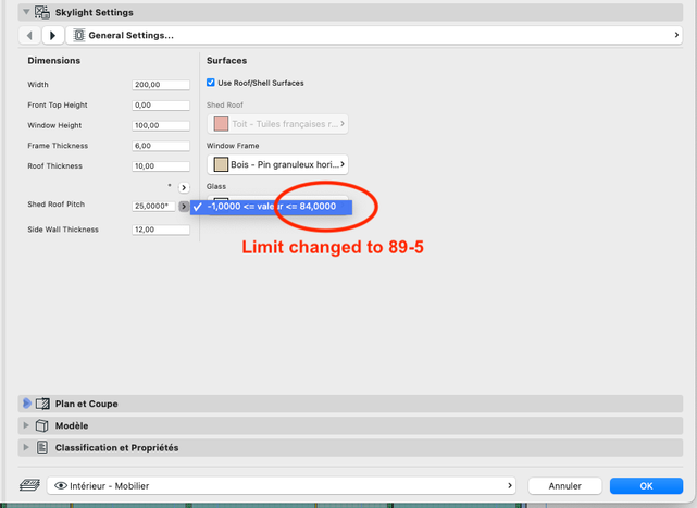

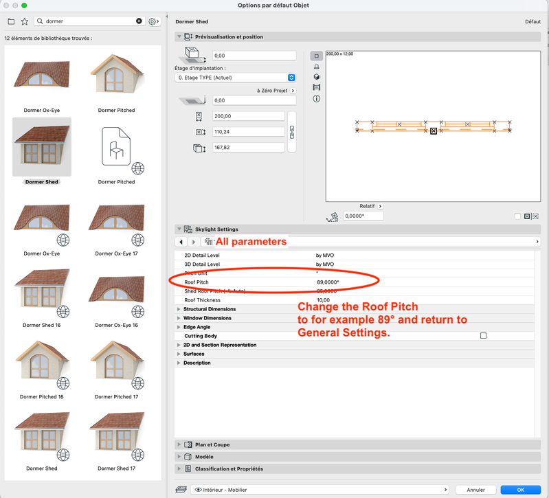

Hi Mike96,
You are wrong, as the limit is a calculated one. It is calculated as Roof Angle° - 5°
No need to edit the object.
This object shall be place on a Roof and need the Roof Angle to calculate some of its parameters.
And after that the Roof Angle may be changed and the object shall recalculate its parameters and insure coherent ones.
When you open the tool options, the object is'nt already place in a roof and it can't read the Roof Angle so the limit is calculated with the default value set in it. The default value is set to 40° that's why at first the limit is 35°.
So if you place the object on a roof with the Roof Window tool, place it first on the roof, select the placed object and open its options, the 35° limit should have been changed.
If you place the object with the Object Tool, there's no Roof Angle to read, so you'll have to set it first yourself, in the All parameters dialog off the object (see images).
