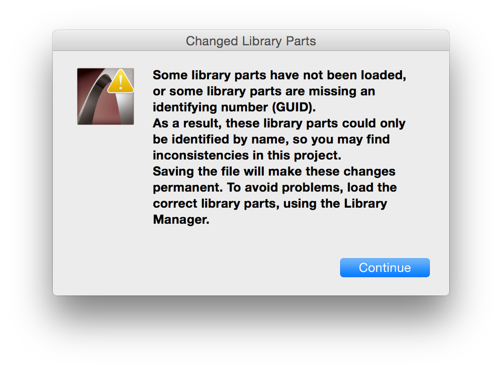

Eduardo Rolon
While updating an AC11 file after the migration you will get this warning that means that AC was not able to load the correct libraries.
