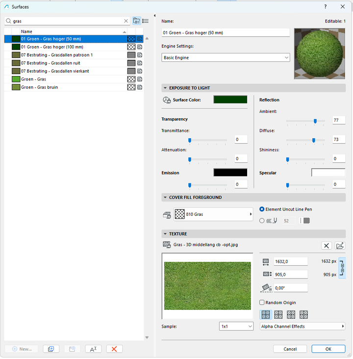

So, next I check that surface in the surface manager, but wierdly enough, there's nothing listed as missing there. See image below for the settings of that surface:
I'm at a loss how to proceed fixing the error message from the Library manager.

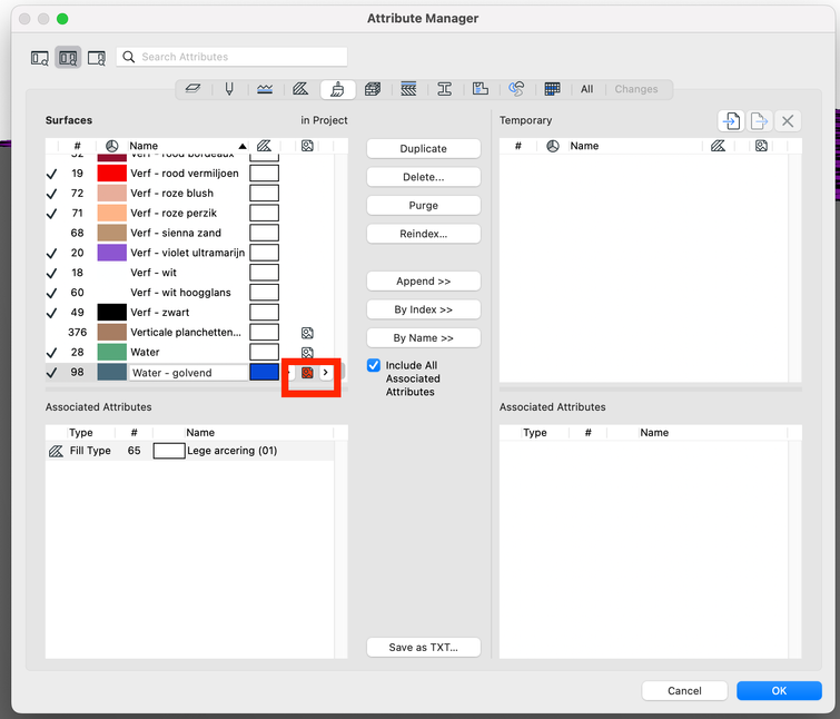

cuba
It may be that a texture is being used elsewhere as a texture. Open the Attribute Manager to find the missing textures; these are indicated with a red icon.

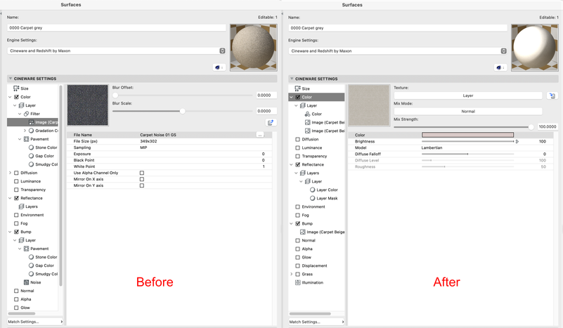

Kori:
Good to know that worked.
Using the Update Cineware Settings (from Basic) command is one way, but it will simplify the Cineware settings. Not a big deal if the Cineware engine is not being used:
Otherwise, one has to search in the Cineware settings to find and replace the missing texture.
