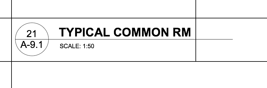

I was wondering if there was a way to reduce the line after the title text.
It seems to be a standard length after all the titles of my placed drawing in the layout book. I would like to make it shorter. I can't find any more options to manipulate it in the title parameters so it must be a GDL thing. If someone knows what to change it would be most helpful.
NCS Drawing Title 2 13
I already have my set to: Link Width to - Title Texts

If you set it to Length parameter instead you can define the length of the line.

I spend a lot of time manipulating the length of these lines for each title. I usually have it set to "length parameter" and recently just discovered the option to set it to "title text." I figured "title text" would make it just long enough to fit under the title text as the name suggests, but it seems to go to some arbitrary length regardless of the title length.
What gives??
