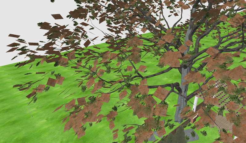

Hi there -- sometimes when I copy objects from project to project, something messes up with the surfaces. See the images of the tree below. When copied over only some of the leaves are correct and some of them turn in to brown squares with a different surface. Any insight?

Do you already have surface attributes in the file you are copying from (source) with the same name as the file you are copying too (destination)?
If an attribute being used by the object, already exists in the destination file with the same name, Archicad will use that attribute in the object, and not bring it from the source file, regardless of whether it’s suitable or not eg in your instance a totally different colour.
You can kind of think of it as the equivalent of ‘use destination formatting’ in word, but not a logical…  It’s one of the many frustrating intricacies of working with attributes between files.
To resolve, either rename the attribute in the source file to something unique, or delete the offending attribute from the destination file.

Actually though I can't seem to figure out how to change the attributes correctly. I opened the object and edited the names of the surfaces of the object in the original file, but it keeps pasting in the same way. I'm I doing that correctly? How should I be changing the attributes?

When copying from project to project, you need to make sure that they both have the same attributes with the same attribute numbers.
Also that the same library are loaded as the texture images will be stored in the libraries.
