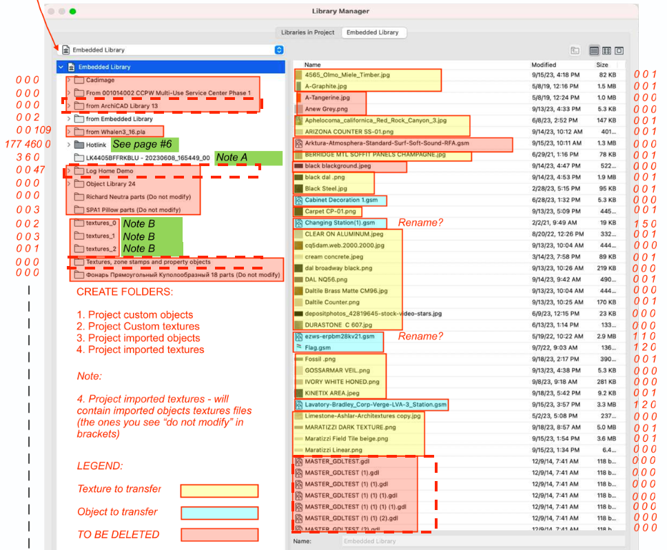

Lucian Laculeanu
My observations during battling these Virus-like elements for years:
- They are randomly attaching to existing attributes.
- Copying elements between projects does help in spreading them out. This is still the biggest spread factor. I like to give people the benefit of the doubt, but there is a higher probability for people not to recognize when they did this move than to admit they did it... So.. "nobody is copying stuff from other places", meaning "no one is trying shortcuts" it is not fully believable in our field.
- Having an "infected" file open while working in a clean one makes this thing jump? I  have listed this only once in my activity as plausible, but I still think that in the hurry of the production process, the person executed a series of rushed shortcuts that helped into something being transferred. That is hard to trace since everyone has its own shortcut map.
I don't want to "jinx" my limited success...but here are some actions I took and it works until that "trust element" is being broken:
- ALL attributes are mapped and all indexes are known. No new attribute is introduced without BIM management vetting. It is easier to pinpoint and delete attributes that may make their way in without your consent.
- No copy paste, unless from vetted source.
- Before Release or Send/receive always check library, and the main target attributes - fills and surfaces. This was hard but is catching on. Regardless of the team member, the user introducing them will be able to see them underlined or green in the case of the library.
- BIM manager is always browsing active projects. (dare to say, acting on suspicions... sad but true...)
- No hot-link is attached unless "clean"
- Limit external links in all projects.
I've attached here a pic of one of the projects that was in a terrible state.  This was part of the assessment process:
In this one I've observed a tendency of the "virus" to re-appear. I chose to trust the users and on a hunch, believing that it could be possible for it to attach itself to one of the "custom attributes", I went for a cleanup that presumed reducing all attributes to sandbox and re-introducing the custom ones after filtering them through a "Sandbox new file" (import XML in and export new one form there). This worked fine until someone copy/pasted.
I gave up then, but now I am trying to come up with a protocol for vetting all archived projects and one to reduce the need of referring to any of them.
I think it is just an us working like crazy thing.
The shrugging of shoulders will continue for some un-numbered years. I hope I am proved wrong on this, but trust always only bit me in the... end.

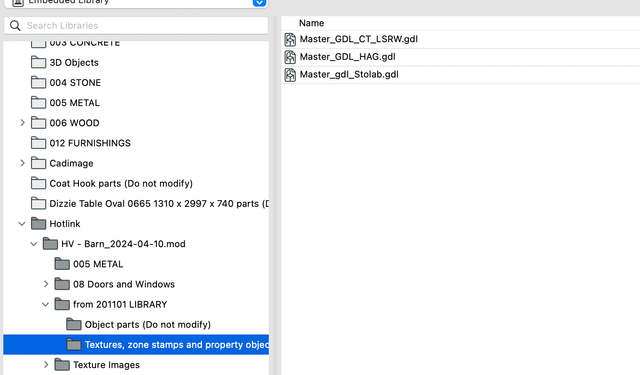

Patrick M
here's a gem. pollution is in the modules. only way to clean it up is to purge all modules, clean up the library and surfaces, build new modules, place new modules (hopefully, but not likely) in the original position.
If we can't get a fix to keep master_gdl.gsm out of the libraries, can we at least have a way to clean up module libraries without purging and rebuilding the whole thing? This particular file has 6 modules, all carry the pollution. It's going to take me all afternoon to clean this up. and since I have to do it when no one else is in the project (so I can reserve all), it's going to actually be an overnight or weekend project. Archicad is basically forcing me to work nights and weekends because of this bS.

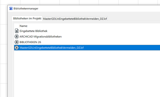

davidzsibrita
I am currently testing a possible workaround. Maybe someone has already tried it and can provide feedback, or does anyone see a potential problem that I don't see yet?
I am currently gathering all the known MasterGDL from our office into a linked library. 
The experience so far is that when this library is linked to a project, no new elements end up in the embedded library after copying.
The attributes are initially included in the project. However, they would be copied in over time anyway.
The advantage is that if you copy something from this file later, nothing gets transferred because nothing is in the embedded library. Copy/Paste is significantly faster.
The idea is that after a few years, no project will have the MasterGDL in the embedded library, and this linked MasterGDL library can be removed from the project templates.
Still, you need to check afterwards to ensure it doesn't pop up somewhere again.

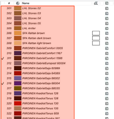

Aaron Bourgoin
Rockstar
The Kling Loading Dock Library Objects seem to place a macro that queried the list of surfaces and if they weren't there added 192 RAL Colours. This continues to haunt the office via the copy/paste virus like feature that GS refuses to remove.
