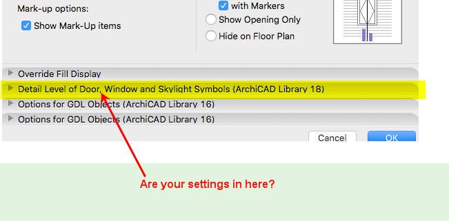

Thank you Erwin, I can't find the controls in model view options to be able to show the window and door casing/architrave. Maybe you could point that out. Attached ids the dialog box I am looking at. Cheers Scott
Are the settings you want in the "Detail Level..." section of the MVO settings?
undefined
Thats it. Cheers
