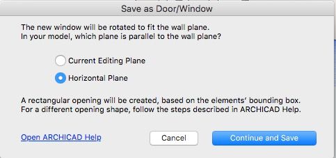

Hello.
I have an issue related to this question.
I tried to do a custom window, I followed all the steps, but I do not know what is wrong with a distance/thickness somewhere, because, when I place the window, it looks like this (see attached photo).
How do I solve this?
Thank you.
Last time I did this was years/versions ago... There you model a custom window flat 'on the ground' and save the elements from 3D as a window object - project elevation 0 represents the exterior wall surface. Elements above 0 are inside the wall, elements below 0 are outside/exterior.
In AC 21, when you save from 3D, you can select the plane that represents the wall face - both for rotation ... and for the distance from the wall face.
From your screenshot, it seems that if you saved from 3D, you needed to move the editing plane to one face of your window and then choose it in the save dialog---or choose the horizontal plane. See this Help article:
https://helpcenter.graphisoft.com/guides/archicad-21/archicad-21-reference-guide/elements-of-the-vir...
You can still use the reveal/offset setting of the Window tool to move the window into the wall cavity to the desired position.

Thank you very much for your reply.
I solved the issue by using the reveal setting you mentioned.
